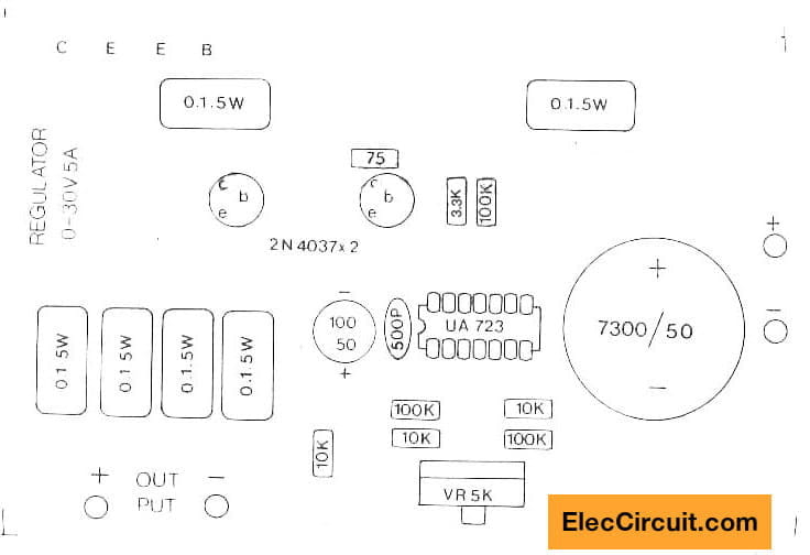

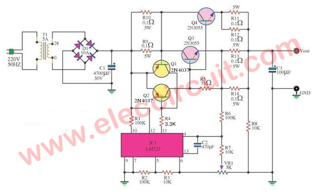

  • ทดลองทำ 5A. ตัวนี้ดีกว่า.....เน้อ...
    link
    0-30V 5A variable benchtop power supply circuit,Output voltage 0-30V and Current 5A max. Use IC LM723 is a voltage regulator designed primarily for series
    MC1723 (ON Semiconductor)
